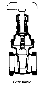

<p class="h2header">Gate Valves</p><div style="width:660px; float:left;"><div style="width:200px; float:left"><br />
<a class='resized_img' rel='lightbox[5bd513a277a408eabf2339bb28a06b75]' id='ipb-attach-url-4398-0-97319800-1793065503' href="https://www.cheresources.com/invision/uploads/monthly_12_2011/ccs-1-0-09401200-1323182244.gif" title="valve5.gif - Size: 1.96KB, Downloads: 420"><img src="https://www.cheresources.com/invision/uploads/monthly_12_2011/ccs-1-0-09401200-1323182244_thumb.gif" id='ipb-attach-img-4398-0-97319800-1793065503' style='width:128;height:250' class='attach' width="128" height="250" alt="Attached Image: valve5.gif" /></a>
</div><div style="width:460px; float:left;">Best Suited Control:  Quick Opening<br />
<br />
Recommended Uses:<br />
1.  Fully open/closed, non-throttling<br />
2.  Infrequent operation<br />
3.  Minimal fluid trapping in line<br />
<br />
Applications:  Oil, gas, air, slurries, heavy liquids, steam, noncondensing gases, and corrosive liquids<br />
<div style="width:230px; float:left"><br />
Advantages:<br />
1.  High capacity                              <br />
2.  Tight shutoff                              <br />
3.  Low cost                                  <br />
4.  Little resistance to flow</div><div style="width:230px; float:left"><br />
Disadvantages:<br />
1. Poor control<br />
2. Cavitate at low pressure drops<br />
3. Cannot be used for throttling</div></div></div><br />
