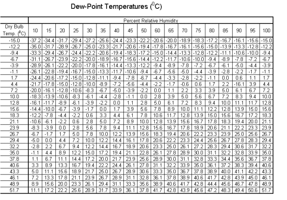

Temperatures of Air<br />
(Fahrenheit)</td><td> </td><td>Table 7: Dew Point<br />
(Celsius)</td></tr><tr><td><a class='resized_img' rel='lightbox[2]' title="Dew Point Temperatures of Air (Â°F)" href="../../../../invision/uploads/images/articles/instable6.gif" target="_blank"><img src="../../../../invision/uploads/images/articles/thumbnails/thumb_instable6.gif" alt="instable6" width="200" height="142" /></a></td><td> </td><td><a class='resized_img' rel='lightbox[2]' title="Dew Point Temperatures of Air (Â°C)" href="../../../../invision/uploads/images/articles/instable7.gif" target="_blank"><img src="../../../../invision/uploads/images/articles/thumbnails/thumb_instable7.gif" alt="instable7" width="200" height="139" /></a></td></tr></tbody></table><p align="left"><span style="font-size: small;">It is crucial that sufficient insulation is added so that the outer temperature of the insulation remains <span style="text-decoration: underline;">above</span> the dewpoint temperature. At the dewpoint temperature, moisture in the air will condense onto the insulation and essentially ruin it.</span></p><p align="left"><span class="h2header">Special Case</span></p><p align="left"><span style="font-size: small;">For the case of a bare pipe running outside, the chart below can be used to adjust the external heat transfer coefficient from 50 W/m2 K (8.8 Btu/h ft2 Â°F) to account for temperature difference and wind velocity:</span></p><table class="imagecaption" border="0" align="center"><tbody><tr><td><a class='resized_img' rel='lightbox[2]' title="Bare pipe external heat transfer coefficient adjustment" href="../../../../invision/uploads/images/articles/ins6.gif" target="_blank"><img src="../../../../invision/uploads/images/articles/thumbnails/thumb_ins6.gif" alt="ins6" width="200" height="110" /></a></td></tr><tr><td>Figure 6: Bare Pipe External Heat<br />

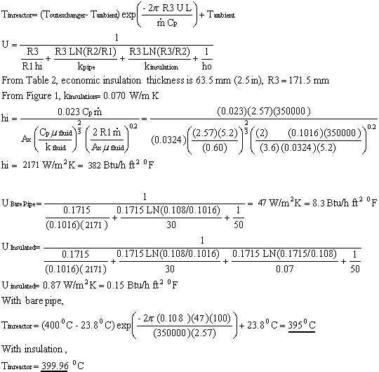

Transfer Coefficient Adjustment</td></tr></tbody></table><p class="h1header"> <hr class="system-pagebreak" title="Practical Example and Summary" />Practical Example</p><p><img src="../../../../invision/uploads/images/articles/ins5.gif" alt="ins5" width="490" height="305" /></p><p>{parse block="google_articles"}In the figure above, a typical reactor feed preheater (interchanger) is shown. The heat exchanger resides on the first level of the structure while the reactor is on the second level. During construction, stream 2 was not insulated because it runs from the exchanger directly to the ceiling away from workers so it posed no safety risk. The reaction is endothermic, so heat is supplied by a Dowtherm jacket surrounding the vessel. The equivalent length of the pipe containing stream 2 is 100 meters. A recent rise is fuel oil costs (which is used to heat the Dowtherm) has prompted the company to search for ways to conserve energy. With the data provided below, you recognize an opportunity for energy savings. Any increase in the reactor feed temperature will reduce the reactor duty and save money. What is the current reactor entrance temperature compared with the entrance temperature after applying the economic insulation thickness to the pipe?</p><p align="left"><em>Data:<br />
</em>Calcium silicate insulation<br />
Temperature of stream 2 exiting the heat exchanger is 400 <sup>Â°</sup>C (752 <sup>Â°</sup>F)<br />
Ambient temperature is 23.8 <sup>Â°</sup>C (75 <sup>Â°</sup>F)<br />
Mass flow = 350,000 kg/h (771,470 lbs/h)<br />
R<sub>inside pipe</sub> = R1 = 101.6 mm (4.0 in)<br />
R<sub>outside pipe</sub> = R2 = 108.0 mm (4.25 in)<br />
Thermal conductivity of pipe = k<sub>pipe</sub> = 30 W/m K (56.2 Btu/h ft <sup>Â°</sup>F)<br />
Ambient air heat transfer coefficient = ho = 50 W/m<sup>2</sup> K (8.8 Btu/h ft<sup>2</sup> <sup>Â°</sup>F)<br />
Fluid heat capacity = Cp<sub>fluid</sub> = 2.57 kJ/kg K (2.0 Btu/lb <sup>Â°</sup>F)<br />
Fluid thermal conductivity = k<sub>fluid</sub> = 0.60 W/m K (1.12 Btu/h ft <sup>Â°</sup>F)<br />
Fluid viscosity = u<sub>fluid</sub> = 5.2 cP<br />
Energy costs = $4.74/million kJ ($5.00/million Btu)<br />
Equivalent length of pipe = 100 meters (328 feet)</p><p align="left"><em>Calculations:<br /><br />
First, we'll assume little or no wind affects the pipe heat loss and we'll estimate the heat loss from the bare pipe:<br />
<img src="../../../../invision/uploads/images/articles/ins8.gif" alt="ins8" /><br />
Now, we'll estimate the radiant heat losses:<br />
<img src="../../../../invision/uploads/images/articles/ins9.gif" alt="ins9" /><br />
where:
&#963; = Stefan-Boltzmann constant = 5.678 x 10<sup>-8</sup> W/m<sup>2</sup> K<br />
A = circumference of pipe to the outer diameter, m<br />
&#949; = emissivity of pipe material, taken at 673 K, assume 0.75<br />
T = absolute temperatures, K<br /><br />
Now, we'll estimate the losses due to convection:<br />
<img src="../../../../invision/uploads/images/articles/ins10.gif" alt="ins10" /><br />
and we'll add these together to arrive at the total heat loss for the bare pipe:<br />
<img src="../../../../invision/uploads/images/articles/ins11.gif" alt="ins11" /><br />
We can now calculate the temperature entering the reactor from the heat exchanger for the bare pipe scenario:<br />
<img src="../../../../invision/uploads/images/articles/ins12.gif" alt="ins12" /><br /><br />
Now, we perform a similar analysis for the insulated pipe:<br />
<img src="../../../../invision/uploads/images/articles/ins7.gif" alt="ins7" /><br />
<p align="left">Temperature difference with insulation is 3.56 <sup>0</sup>C. While this doesn't sound too dramatic, consider the energy savings over one year with the insulation:</p><p align="left">Q = mass flow x Cpfluid x temperature difference<br />
Q = (350,000 kg/h)(2.57 kJ/kg K)(3.56 K) = 3,202,220 kJ/h<br />
3,202,220 kJ/h x 8760 hours/year = 28,051 million kJ/year<br />
28,051 million kJ/year x $4.74/million kJ = <span style="text-decoration: underline;">$132,961 per year</span></p><p align="left"><span style="color: #0000ff; font-size: small;">By insulating the pipe, energy costs have decreased by nearly $133,000 per year</span></p><p class="h1header">Summary</p><p align="left"><span style="font-size: small;">There are many factors to consider when thinking about insulation.  Insulation save money for certain, but it can also be effective as a safety and process control device.  Insulation can be used to regulate process temperatures, protect workers from serious injury, and save thousands of dollars in energy costs.  One should never overlook it's usefulness.  It's also bad practice to consider only one of the important factors discussed in this article.  The key is to consider all factors that will be affected by installing insulation on a pipe or any other piece of equipment.  </span></p>]]></description>
