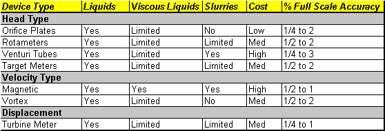

Table 1:  Comparison of Popular Flow Measurement Devices
Head Devices
     Head type devices measure flow by constricting a stream and measuring the resulting pressure drop.  The pressure drop can then be related to a flow.
Orifice Plates
     An orifice plate is a very simple device installed in a straight run of pipe.  The orifice plate contains a hole smaller than the pipe diameter.  The flow constricts, experiences a pressure drop, and then the differential pressure can be related to a flow.

Venturi
     A venturi tube (also called the Herschel Venturi tube) also measures flow rates by constricting fluids and measuring a differential pressure drop.
flowmeas11.gif (1787 bytes)      Venturi tubes allow for flow measurement with lower head losses than orifice plates.  Venturi tubes of cast iron cones are most commonly used in pipes with diameters of 4 to 32 inches (10 to 80 cm).  Pipes of up to 10 inches (25 cm) in diameter usually utilize machined venturi constrictions.  Larger diameter pipes (to 48 inches or 1.2 m) usually employ a welded sheet metal convergence.  Venturi accuracy is best for Reynolds numbers between 105 and 106.  Again, for a discussion on relating venturi pressure drops to flows, see LMNO Engineering.

     Rather than using a constant restriction area and a variable pressure differential, rotometers use a variable restriction and a constant pressure differential to measure flow.  Typically, rotometers are used to measure smaller flows and the reading is usually done locally, although transmission of the readings is possible.

     Probably the most common velocity device used for flow measurement is the magnetic flowmeter.  Magnetic flowmeters cause no head loss and they can easily measure liquids with solids in suspension.  By their design, they produce an electrical signal ideal for plant transmission.
     In a magnetic flowmeter, the pipe is lined with a nonconducting material and at least two electrodes are mounted flush with the nonconducting wall.   Electromagnetic coils surround the flow path with a uniform magnetic field.   Faraday's Law dictates that the voltage produced by a conducting fluid flowing through a magnetic field is directly proportional to the velocity of the fluid.
     The major disadvantage of magnetic flowmeters is that they cannot be used for hydrocarbons due to hydrocarbon's low conductivities.

     The most common displacement flow-measuring device is the turbine meter.  In a turbine meter, a rotor is placed in the flow path.   Usually, the rotor is magnetically coupled so that each rotation produces a pulse.   The spin of the rotor is proportional to the velocity of the fluid.  The turbine meter is highly accurate and durable.  Turbine meters are restricted only by the fact that they must be used in clean, noncorrosive services.
