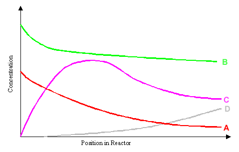

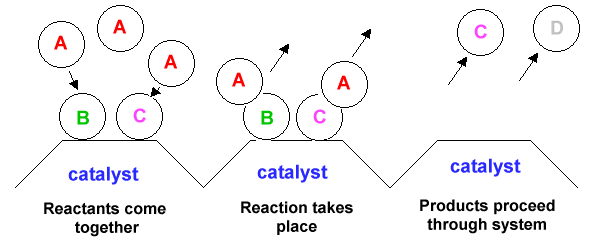

     Have you ever wondered what really happens inside a chemical reactor?  In short, as the reaction proceeds the reactants decrease in concentration while the products increase in concentration.  Consider the following two reactions:
A + B --> C
     A + C --> D
where C is the desired product.  Let's assume that this reaction takes place over a solid catalyst.
     The reaction concentration profile may resemble:
