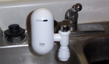

     Finally, I noticed the water filter on our kitchen sink.   This filter contains one of the oldest filtration medias known to chemical engineers....activated carbon.  Via a process called adsorption, small particles adhere to the activated carbon as the fluid passes through the filter.   Chemical engineers have long used activated carbon to purify liquids and gases.   Perhaps the most common application in use today in the chemical industry is the use of carbon to remove tiny particles from gas streams before they are released to the atmosphere.  Without the activated carbon, these particles could make the surrounding area a very unpleasant place to live or work.  Below, I've shown our small carbon filter and an industrial size vessel filled with activated carbon.
