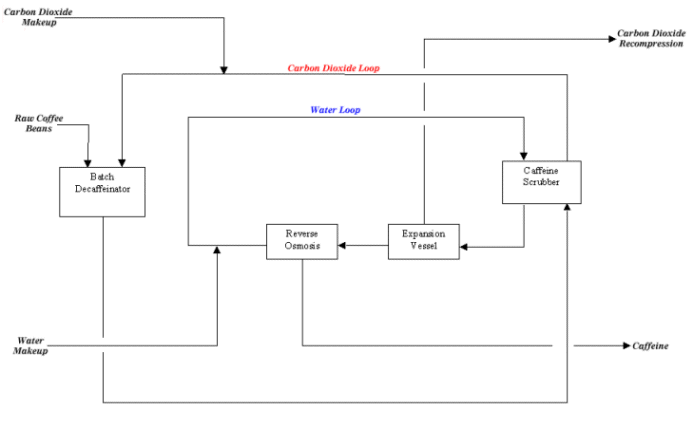

     In the search for another alternative, the use of solvents termed "supercritical" solvents looked like an attractive solution.  "Supercritical" refers to solvents that are at temperatures and pressures beyond their critical points.  For example, the critical pressure of a substance is the highest pressure at which the substance can exist as a true liquid, no matter what the temperature.  However, the gases at supercritical conditions are nearly as dense as some liquids due to the extreme temperature and pressure.  This makes these gases ideal for solvents.
     The most popular supercritical fluid (gas) is supercritical carbon dioxide.  The reason for its popularity is it's relatively mild critical points of 31.1 0C and 73.9 bars.  It is also abundant and mostly benign.  Other solvents, such as water, have much higher critical points (374 0C and 222.3 bars).  Thus it would cost much more to use water as a supercritical fluid because larger compressors and thicker vessels would be necessary.  Luckily for engineers, they also found that the most popular supercritical solvent (carbon dioxide) also had another advantage in the decaffeination process.  While it easily removed most of the caffeine from the raw coffee beans, the aromatic compounds responsible for taste and smell were largely left in the beans.
The Process
     The raw beans are placed into a batch decaffeinator vessel.  Supercritical carbon dioxide is run through the beans for about 10 hours, which removed nearly 97% of the caffeine.  The caffeine-rich carbon dioxide is contacted with water in he caffeine scrubber.  This transfers nearly all of the caffeine in the carbon dioxide to the water.  The caffeine is easily removed from the water in a reverse osmosis unit.  Once the carbon dioxide is cleaned of caffeine, it can be recycled and the same can be said for the water.
