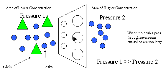

Desalting by Reverse Osmosis
     Osmosis refers to the movement of water from an area of high concentation to an area of lower concentration.  Therefore, reverse osmosis is the forcible movement of water from an area of low concentration to an area of higher concentration, or against the water's natural concentration gradient.  In desalination, a semi-permeable membrane (a membrane that allows some material to pass through, but not other materials) is used to separate water from salt and other dissolved solids.

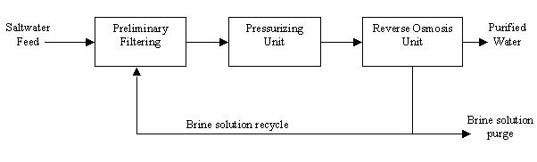

     The most common desalination membran used is cellulose acetate (a chemically modified plant cellulose).  Below is a typical block flow diagram for a reverse osmosis desalination plant:
     The brine or salt solution is usually disposed of by land spreading, sewer systems, deep well injection, piping to ocean, or solar evaporation ponds.  The disposal method chosen is dependent on geographical location, brine concentration, and waste disposal costs.

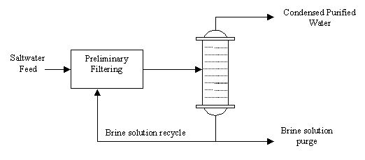

Desalting by Distillation
     Desalination can also be performed by distillation.  Distillation of saltwater is less common than reverse osmosis due to the large energy costs involved to achieve the necessary purities for municipal use.  Generally, reverse osmosis setups have lower operating costs than those using distillation.
