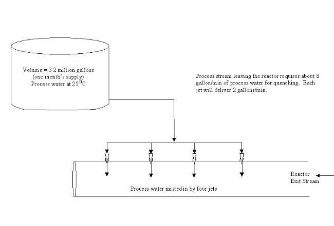

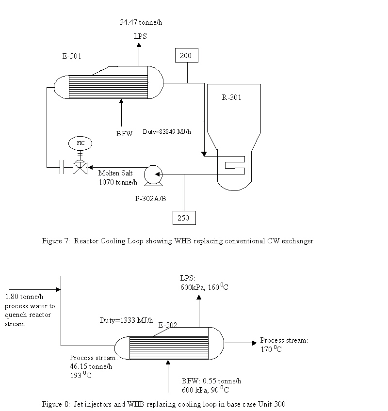

          The alterations to the process heat integration are shown in Figures 7 and 8. These waste heat
boilers will generate in excess of $2 million annually for the new plant. Heat exchanger E-302, along with
a process water injection system and V-301, will effectively replace the quench tower from the current
process. The process water used will either by piped from a supplier or fed from a 3.2 million gallon tank
on site. This tank will hold one month's supply of process water. This water is at ambient temperature
(250C) and is introduced into the reactor effluent by a system of four injection jets shown in Figure 9.
Each jet will inject 2 gallons per minute into the process stream for quenching.
Figure 9: Apparatus for quenching stream exiting reactor, R-301
