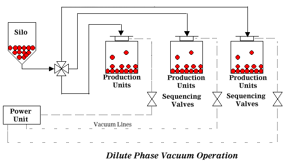

1.  Dilute phase vacuum operation

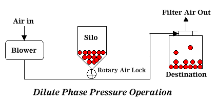

2.  Dilute phase pressure operation

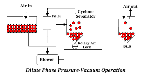

3.  Dilute phase pressure-vacuum operation

Vacuum systems allow multiple product inlets through the use of simple diverter valves.  However, it becomes costly to have multiple destinations because each must have its own filter receiver with partial vacuum capability.  Vacuum systems are also more "distance sensitive" than pressure systems due to the maximum pressure differential of 5.5 to 6.0 psi.  Dilute phase pressure systems can easily achieve pressure differentials of 12 psi.   Pressure-vacuum operation (utilizing both methods) are sometimes ideal for a given conveying setup.  A very common application is the unloading of a standard railcar.   Since the cars cannot be pressurized, air is pulled from the outside, through the car (carrying solids with it) to a filter.  Then after the filter, a blower can be used to forward the solids to the final receiver.
