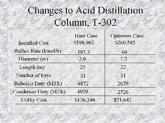

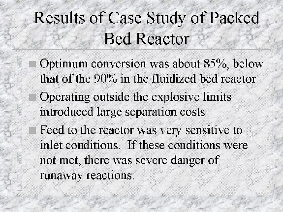

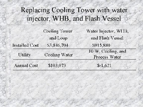

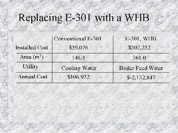

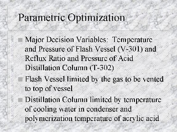

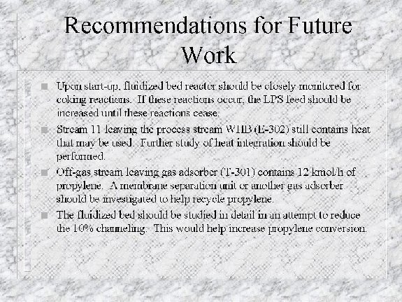

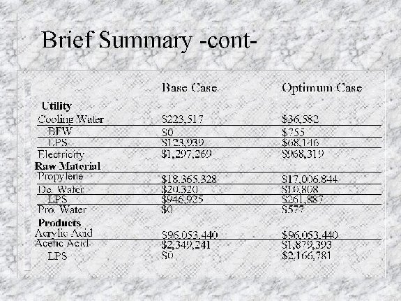

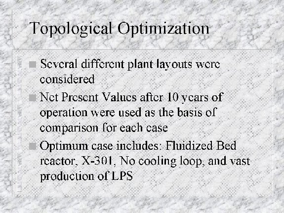

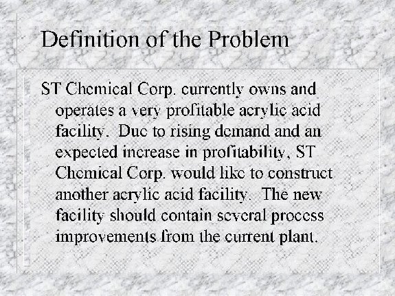

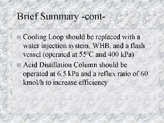

 Below you will find the presentation that I used for the design project "Acrylic Acid Unit 300".
 Notice that none of the slides contains an over-abundance of information and that there are
frequent comparisons made between the base case and the optimum case.  Although these
slides are a little hard to read, yours shouldn't be....I just had to fit them onto this web site!
 These slides were contructed with Powerpoint from Microsoft.  Finally, the optimized PFD
should be shown during your presentation as well.  You can see mine here!
