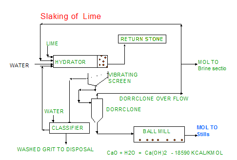

Lime slaking and factors that affect the process
Since lime slaking is an integral part of treatment systems in water, wastewater, air pollution, and process industries, its performance will influence the overall effectiveness of the process as well as operation costs.
(Limestone) CaCO3 + HEAT-------> (Calcium Oxide) CaO + CO2
However, CaO is unstable in the presence of moisture and CO2. A more stable form of lime is calcium hydroxide Ca(OH)2.
(Calcium Oxide) CaO + (Water) H2O -----> Calcium Hydroxide Ca(OH)2 + HEAT 3

Equipment used for the slaking process
There are basically two types of lime slakers available on the market. They are:
·   Slurry Detention Slakers
·   Ball Mill Slakers
A slaker must mix the correct amount of quick lime (CaO) and water, hydrate the quicklime, and separate the impurities and grit from resultant calcium hydroxide slurry.
Slurry slakers
A slurry slaker generally uses an initial lime-to-water ratio of 1 to 3.3 to 1 to 5 depending on the make of equipment and quality of CaO and water. Typically a slurry slaker, sometimes called a detention type slaker, is composed of two chambers.  The first chamber is called the slaking chamber where lime and water are mixed. The second chamber is usually used as a grit removal chamber. The lime slurry flows by gravity from the first chamber to the grit chamber. The slurry viscosity is reduced in the second chamber by the addition of cold water to allow the heavier grit to settle to the bottom of the second chamber where the grit is elevated and discharged by a screw.
The slurry slakers are generally designed for a retention time of 10 minutes at full rated capacity. This means that a particle of CaO from the time it enters the slaker until it exits into the grit remover takes an average of 10 minutes.
Ball mill slakers
Ball mill slakers are an adaptation of ball mills, which originally were designed for wet and dry grinding, to the job of slaking. Two types of ball mills are used for slaking, horizontal and vertical. Ball mill slakers are generally used where:
·         Capacity required is too large for other types of slakers.
·         Due to zero discharge conditions at the site no grit discharge is allowed.
·         When water available is too high in sulfates or sulfites for regular slakers.
The ball mill slakers are much more expensive than paste or slurry slakers. They are available in sizes ranging from 1,000 lb/hr to 50 tons/hr. Schematic one shows an attritor type vertical ball mill lime slaker.
The ball mill slakers are equipped with an external classifier, which separates slurry from the oversized grit and impurities. The oversize grit is recycled back into the mill for regrind.

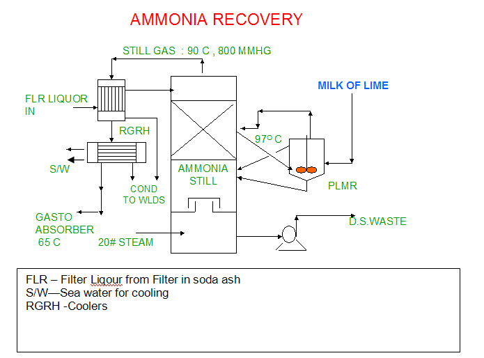

Factors affecting ammonia recovery plant-lime path
In the ammonia recovery process, the role of slaked lime is to supply one of the reactants (milk of lime) for pre-limer reaction to remove the fixed ammonia (Ammonium chloride) from filter liquor of the soda ash plant.  Reaction between the lime and fixed ammonia is an endothermic reaction.  The reaction occurs at the reaction plane and it is controlled by the diffusion of milk of lime to interface.  The availability of milk of lime is determined by the solubility of milk of lime in the water. The reaction of Ca(OH)2 and NH4Cl at reaction plane creates the necessary driving force for dissolution of Ca(OH)2 and diffusion into the interface and its process goes on as long as both the reactants are present.  Schematic two shows the recovery of ammonia.  The overall reaction in the ammonia recovery process is:
Ca(OH)2  +  2 NH4Cl  ------------------> Ca Cl2 +2 NH3 + H20
1.      Lime concentration :
The lime concentration is desired around 220 to 280 Titer. Higher concentration of lime leads to low pressure stream saving
2.      Calcium carbonate and inert materials
Milk of lime contains around 30 to 40% calcium carbonate as suspended solids which are not taking part in the reaction.  The suspended solids along with inerts  and sulfate reduces the working life of ammonia stills.
3.      Particle Size
Pre-limer reaction is the endothermic reaction and is controlled by mass transfer of Ca(OH)2 particles from bulk of the liquid-to-solid interface. Smaller particle size will reduce the reaction time in the reactor.
