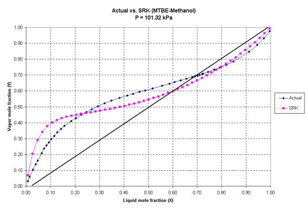

     As an example we will compare how each model predicts the VLE behavior of a MTBE-methanol mixture at atmospheric pressure. This system can be classified as being slightly to moderately non-ideal. As you can see by the graphs below, if someone would have used the SRK method to predict this behavior, the result would have been....well....not good! Mr. Henry Z. Kister gave a good example of why there is no replacement for engineering judgement in his book entitled Distillation Design (McGraw Hill 1992):
     About 15 years ago I was applying a leading and very well known literature correlation as part of my graduate thesis. I punched in keys and the computer printed out results. For some reason the results did not look right. Upon investigation, I discovered the unbelievable: the correlation just did not work for my case. Not that the correlation was bad; over many years, it gained a very healthy reputation. It just happened that it had limitations, just like every other correlation. The limitations of this correlation were fairly well explored, but a quarter of a century after it was derived, I found the hard way that it had one more limitation which remained hidden over all these years.
