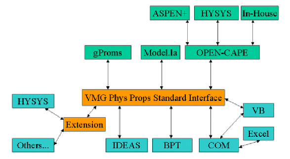

On top of this core set of classes, software interfaces are implemented allowing our property package system to be used by many diverse applications, ranging from a steady state and dynamic simulator such as HYSYS to batch process simulators, operator training simulators and productivity tools such as Excel, Java and Visual Basic. This functionality is shown schematically in Figure 11.

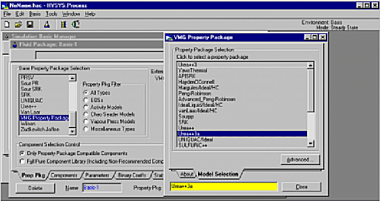

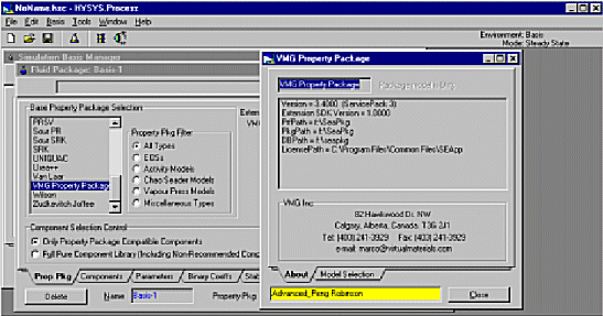

This modern approach to software engineering provides immediate benefit to the user. Usually a process engineer will be familiar with a process simulator. By installing our property package system in his or her computer, the user has immediate access to the physical property calculations provided by our physical property system without having to learn how to use a new process simulator. For example, the HYSYS process simulator was built with an open software architecture in mind, and our property package provides an interface, which HYSYS can recognize. From that point on, the user can select our property package system directly from inside the simulator:
Figure 12: Selecting Virtual Materials Group Property Package System from inside the HYSYS Process Simulator
Figure 12 shows what the user of the HYSYS process simulator would see in the basis environment. The basis is the section of the program where thermodynamic models and components are selected for the simulation. Note the Virtual Materials Group Property Package System appears in the Base Property Package Selection scrollable list. With VMG Property Package selected, the form displayed on the right appears, where the user can select the appropriate Virtual Material to represent his or her system of interest as shown in Figure 13.
Figure 13: Selecting a Virtual Material to represent a specific process.

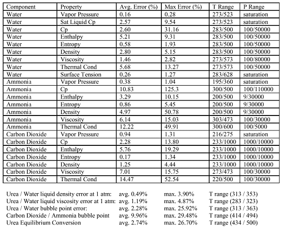

  2. Users should know how good and how bad the software is when used to simulate his process. Virtual Materials Group performs extensive validations on its property packages and is able to create a "boiler plate" for each property package it produces, thus allowing engineers to know a-priori the performance of a property package. This in turn allows the user to critically evaluate the performance of the property package and interact with Virtual Materials in the event errors are not reported for a specific condition of interest.
Validation of property package systems is a fundamental part of an industrial grade property package system and considerable effort is spent in this feature before a property package is actually released. For example, UREA++ 2.0's boilerplate is reproduced in Table 3.
Table 3:  UREA++ Version 2.0 Boiler Plate – Temperatures (K) and Pressures (kPa)

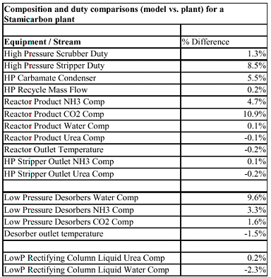

Several different urea production flowsheets were successfully modeled using the physical behavior modeled by Virtual Materials Property Package System and the calculation sequencing provided by AEA's Software Engineering process simulator HYSYS. Engineers can be productive from the start by having access to rigorous thermodynamic calculations while not having to learn a new process simulation tool. Table 4 summarizes the typical errors found when modeling a urea plant using UREA++.
Table 4: Model versus actual plant comparisons
