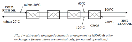

The Rupture of GP905
The vessel that exploded at Longford was a shell and tube heat exchanger, GP905, located in Gas Plant 1. In normal operation, cold rich oil entered the vessel at 60°C and exited at 100°C, being heated by a counter flow of hot lean oil entering at 230°C and exiting at 120°C. It was a "hot service" vessel, and not expected to ever experience temperatures lower than ambient.
Heat transfer between the two process streams was achieved in other heat exchangers as well as GP905, as depicted in Fig. 1. The cold rich oil entered the first of these exchangers at or below minus 30°C.
The prosecution argued that GP905 exploded as a result of:
·          flow of hot lean oil ceased due to a pump shutdown, and remained so for at least three hours
·          flow of the cold stream (at first cold rich oil and then cold hydrocarbon condensate) continued
·          without the heating medium, GP905 dropped in temperature to below minus 30°C which was way below its minimum design safe operating temperature
·          the weld metal of GP905 became brittle at the low temperature and susceptible to fracture if unduly stressed
·          approximately 4 hours after the pumps shut down they were restarted and flow of hot lean oil was re-established into GP905
·          hot lean oil entered the cold exchanger, producing sudden thermal stresses and causing a weld to crack
·          the vessel had been kept at its normal operating pressure and, upon the weld cracking, violently ruptured
