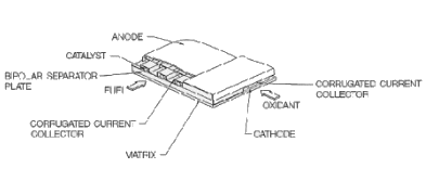

The Cell
The construction of an individual fuel cell resembles a sandwich. In the DFC, fuel and oxidant are fed through separate manifolds to the anode and cathode compartments of the cells, divided by a bipolar separator plate. The anode is bathed with fuel, the cathode with oxidant (air and carbon dioxide). These electrodes consist mainly of porous, sintered nickel (anode) or nickel oxide (cathode). Layered between the electrodes is the carbonate electrolyte contained in a porous (ceramic) matrix.
Figure 3:  Construction of a Fuel Cell
Individual cells generate a relatively small voltage, on the order of 0.7 to 1.0 volts each (after accounting for resistance losses).
The current produced by an individual fuel cell is approximately a linear function of cell surface area. For commercial cells, the cell area is a trade-off between acceptable current (amperage) levels and manufacturing and transportation constraints. The most common dimensions are two by four feet area.
To develop higher voltages, cells are "stacked" and connected in series. As the diagram indicates, stack design considerations include manifolds for uniform gas distribution to each cell and to maintain cell compression and mechanical integrity at the stack’s high operating temperatures. For Energy Research Corporation’s (ERC) commercial megawatt-class power plants, individual stacks contain about 340 cells. Between each 10-cell grouping is a special catalyst-containing cell to improve internal reforming. Each stack has interconnections for fuel, air, and electricity.
