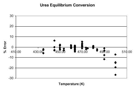

Equilibrium Reactor Modeling
A useful tool for mass and energy balances in a urea plant is an equilibrium reactor, which can be used to estimate the performance of actual reactors at optimum conditions (from a thermodynamic point of view). Which can be used as a first approximation for the synthesis reactor. Usually reactors with more than nine baffles approach the results one would get by assuming complete chemical equilibrium as reported by Uchino (5). Also, equilibrium reactors provide a convenient tool for initial studies on how water will affect the reactor performance and can replace empirical graphical relationships used in hand calculations (22, 23). For the we use the ionic reaction system defined by reactions 3-7. Comparisons between predicted and calculated results can be found in figure 9.
Figure 9: Error in Predicting CO2 Conversion for Urea Equilibrium Reactor (24)

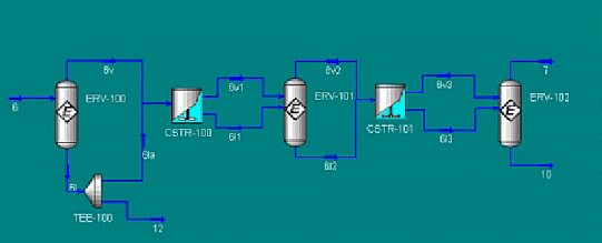

Reactor Kinetic Model
The plate type synthesis reactor can be modeled as a set of equilibrium and reactor stages. Since the Carbamate formation reaction is fast it can be modeled as an equilibrium reaction. The carbamate decomposition into urea is slow and is modeled as a kinetic (CSTR) reaction. The equilibrium constants for the carbamate formation are well known, as are the kinetic parameters for the carbamate decomposition into urea. It is found that for plate type reactors, 3 stages are often enough to model the synthesis reactor. A typical example is shown in Figure 10.
Figure 10: Kinetic Reactor Model
Determine kinetic reactor volume
The kinetic reactor volume of each stage can be adjusted such that the desired urea formation is achieved at the known process conditions. Thereafter the reactor model can be used for predicting the performance due to changing flows and compositions.
