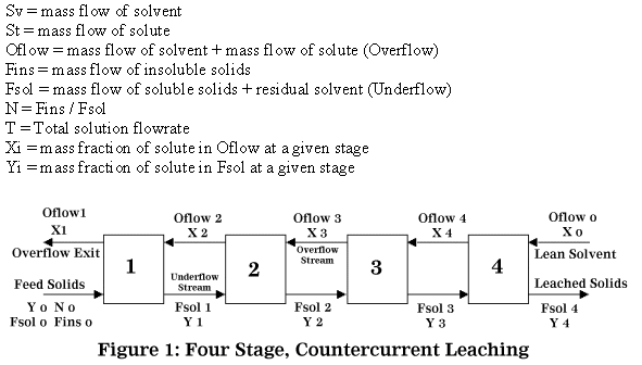

General Arrangement and Nomenclature
The following nomenclature is used in conjunction with Figure 1 below:
Sv = Mass flow of solvent
St = Mass flow of solute
Oflow = Mass flow of solvent + mass flow of solute (Overflow)
Fins = Mass flow of insoluble solids
Fsol = Mass flow of soluble solids + residual solvent (Underflow)
N = Fins / Fsol
T = Total solution flowrate
Xi = Mass fraction of solute in Oflow at a given stage
Yi = Mass fraction of solute in Fsol at a given stage
leach1
Figure 1: Four Stage, Countercurrent Leaching

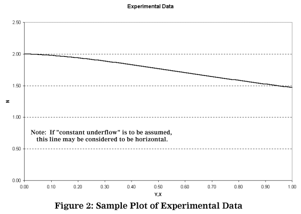

At this point, we introduce the graph construction.  A plot of N vs. X,Y is used to step off stages for leaching calculations.  But, just as equilibrium data is necessary for a McCabe-Thiele diagram in distillation, leaching calculations require that you know something about how the solids and liquids interact.   Settling experiments can provide data such as those shown in Table 1.  Essentially, N = Fins / Fsol so as more solvent is mixed with the solids, Fsol increases, N decreases, and Y increases.  A plot of this data may resemble Figure 2.
leach6
Figure 2: Sample Plot of Experimental Data

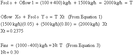

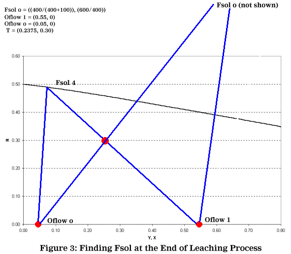

Once this data is obtained, four distinct points are known and can be plotted:  Fsol o, Oflow 1, Oflow o, and T.  For example, let's say that 1000 kg/h of solids, wetted with 100 kg/h of solvent, will be fed to a leaching system and of this amount 400 kg/h are soluble in the solvent.  The 1500 kg/h of lean solvent coming from the separation section contains 5 wt % solute.  The desired mass fraction of solute leaving the leaching system is 0.55.  All of these values are determined by systems outside the leaching equipment or they are dependent on the leaching solvent, operating temperature, or particle size.  For the example above, our graph would resemble Figure 3.
leach7
Figure 3: Finding Fsol at the End of the Leaching Process
Point T is found by:
leach8
Since the material balance dictates that Oflow o, T, and Fsol o are in a straight line, and Oflow, T, and Fsol 4 be in a straight line, we can find Fsol 4 graphically with an accurate graph.  Notice that the experimental data ultimately determines the final quality of the leached solids.

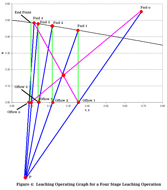

We still have not addressed how to find the total number of stages required and intermediate solute concentrations.  In order to do this, we introduce the operating point equation.
P = operating point or difference in flows
Np = N-coordinate of the operating point
Xp = X-coordinate of the operating point
leach9Eq. (4)
leach10Eq. (5)
leach11Eq. (6)
The operating point is now used to construct tie lines for the intermediate stages as shown in Figure 4.
leach12
Figure 4: Leaching Operating Graph for a Four Stage Leaching Operation
Parting Word
Leaching calculations are at times confusing due to the "clumsy" nomenclature and the physical substances involved.  Once you've identified the variables and the experimental data that you have and you're able to construct a graph such as Figure 3 the remaining steps are relatively simple.  When constructing Figure 4, be sure that the graph scale is sufficiently large to plot the operating point, it's your guide to the remainder of the process.
