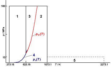

The IAPWS-IF97 divides the thermodynamic surface into five regions (see figure below):
  • region 1 for the liquid state from low to high pressures,
  • region 2 for the vapor and ideal gas state,
  • region 3 for the thermodynamic state around the critical point,
  • region 4 for the saturation curve (vapor-liquid equilibrium),
  • region 5 for high temperatures above 1073.15 K (800 °C) and pressures up to 10 MPa (100 bar).
Regions of IAPWS-IF97
For regions 1, 2, 3 and 5 the authors of IAPWS-IF97 have developed fundamental equations of very high accuracy. Regions 1, 2 and 5 are covered by fundamental equations for the Gibbs free energy g(T,p), region 3 by a fundamental equation for the Helmholtz free energy f(T,v). All thermodynamic properties can then be calculated from these fundamental equations by using the appropriate thermodynamic relations. For region 4 a saturation-pressure equation has been developed.
In chemical engineering applications mainly regions 1, 2, 4, and to some extent also region 3 are of interest. The range of validity of these regions, the equations for calculating the thermodynamic properties, and references are summarized in an Adobe pdf-file. The equations of the high-temperature region 5 should be looked up in the references.
For regions 1 and 2 the thermodynamic properties are given as a function of temperature and pressure, for region 3 as a function of temperature and density. For other independent variables an iterative calculation is usually required. So-called backward equations are provided in IAPWS-IF97 which allow direct calculation of properties as a function of some other sets of variables (see references).
Accuracy of the equations and consistency along the region boundaries are more than sufficient for engineering applications. Details can be found in the references.
