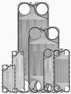

GENERAL INFORMATION
The gaps between the plates in plate and frame heat exchangers can be adjusted according to the degree of fouling (deposits, corrosion, etc.) that is expected.
plates.JPG Plates of Plate and Frame Heat Exchanger
The counter-current flow of fluids that occurs in plate and frame heat exchangers allows approach temperatures as low as 1 to 2°F.
Gaskets ensure that the cold fluid (blue) and the hot fluid (red) don't mix. Alternatives to the traditional gasket seal include brazing and laser-welding.
The plates are stacked in an alternating manner to cause the counter current flow. The diagram below shows the flow in a heat exchanger. The design allows for the two media to flow in alternate directions and not be mixed. However, heat can be transferred from one medium to the other through the plates.
