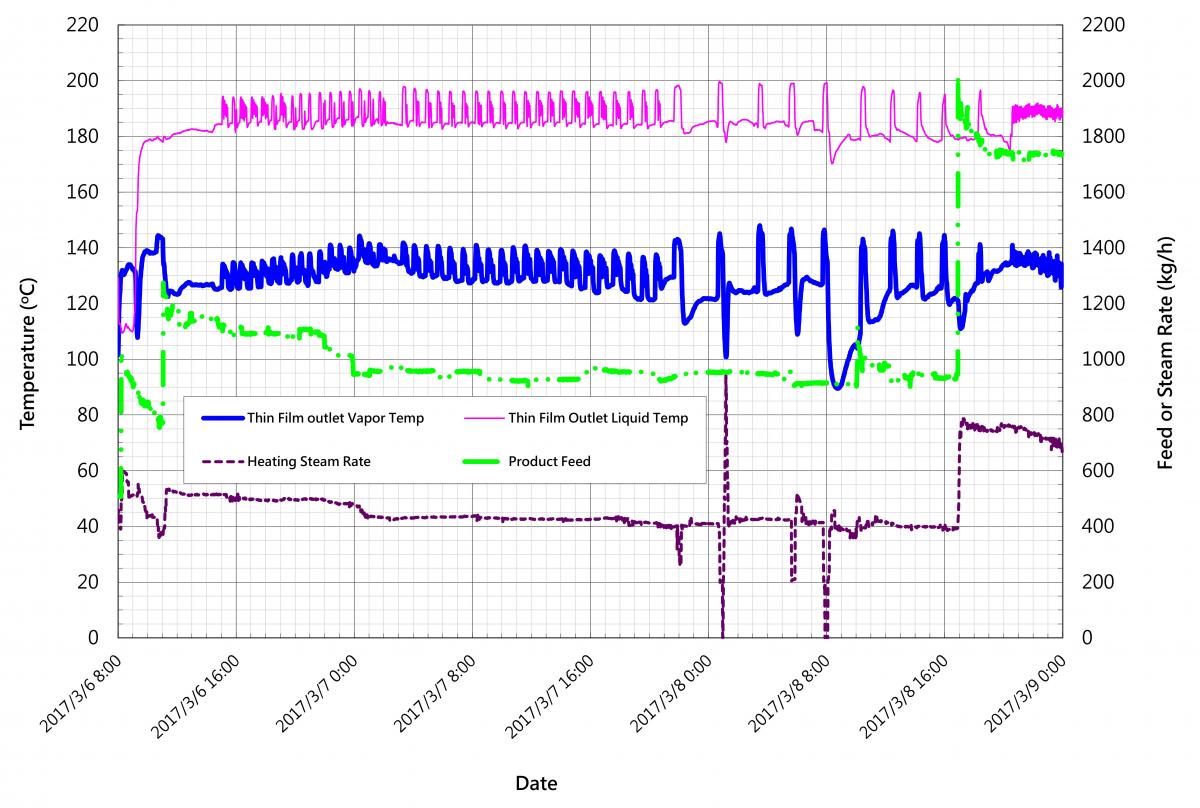

Hi Sirs,
How to explain the phenomena of temp. pulsation at Agitated thin film evaporator outlet?
Purpose : Recover Ethylene Glycol
Agitator speed : 60 rpm
Feed composition
Water 2.0 wt%
Ethylene Glycol 40.0wt%
Heavy Ends 58.0 wt%
Sam
