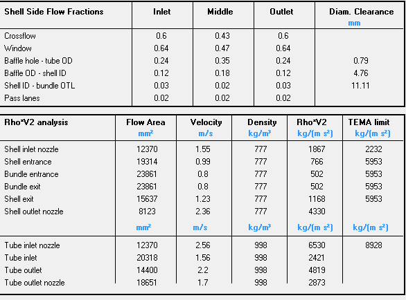

i use the aspen EDR to design my shell and tube heat exchanger and to calculate my costs.
In my results (see the pictures) is the following problem:

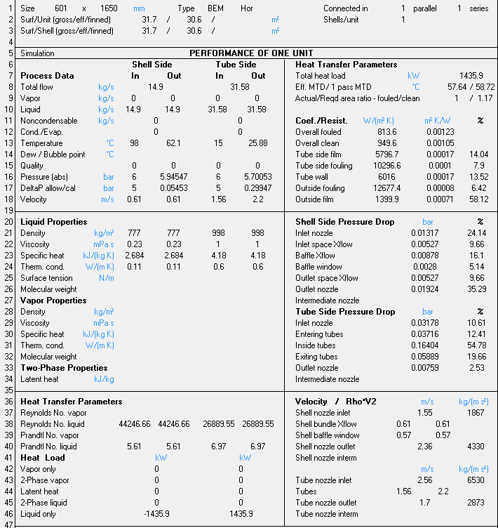

My velocity of the tube side change. But usually the inlet velocity of the tube should be the same as the outlet velocity, because the diameter is the same. Just notice that my physical properties are temperature independent (as you can see in the second picture).
So together: My velocity in the tube change
but the Reynolds-number is constant.(picture one)
My density is constant but my flow area change (second picture).
Now i want to know, my the flow area is changing? My tubes have a certain diameter and the diameter from the inlet to the outlet should be constant and not changing.
