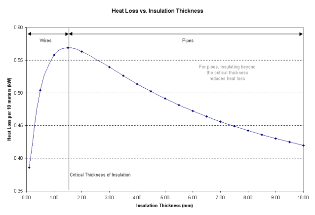

Since heat loss through insulation is a conductive heat transfer, there are instances when adding insulation actually increases heat loss.  The thickness at which insulation begins to decrease heat loss is described as the critical thickness.   Since the critical thickness is almost always a few millimeters, it is seldom (if ever) an issue for piping.  Critical thickness is a concern however in insulating wires.  Figure 3 shows the heat loss vs. insulation thickness for a typical insulation.  It's easy to see why wire insulation is kept to a minimum as adding insulation would increase the heat transfer.

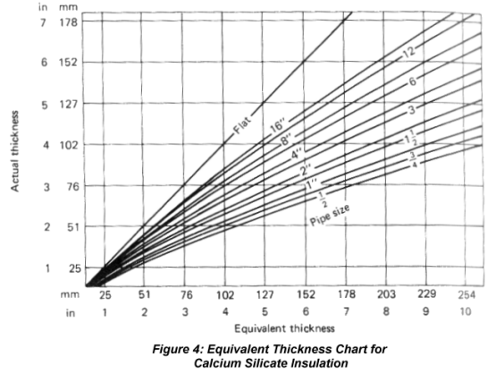

    As you can see, using heat balance equations is certainly a valid means of estimating surface temperatures, but it may not always be the fastest.  Charts are available that utilize a characteristic called "equivalent thickness" to simplify the heat balance equations.  This correlation also uses the surface resistance of the outer covering of the pipe.  Figure 4 shows the equivalent thickness chart for calcium silicate insulation.  Table 5 shows surface resistances for three popular covering materials for insulation:
With the help of Figure 4 and Table 5 (or similar data for another material you may be dealing with), the relation:
can be used to easily determine how much insulation will be needed to achieve a specific surface temperature.  Let's look at an example to illustrate the various uses of this equation.
Example of Outer Surface Temperature Determination:
Your supervisor asks you to install insulation on a new pipe in the plant.  Recently, two workers suffered severe burns while incidentally touching the new piping so safety is of primary concern.  He instructs you to be sure that this incident does not repeat itself.  The pipe contains a heat transfer fluid at 850 0F (454 0C).  The ambient temperature is usually near 85 0F (29.4 0C).   After checking the supplies that you have available, you notice that you have calcium silicate insulation and aluminum available for covering.  You would like to insulate the 16 inch pipe for a surface temperature of 130 0F.
Tsurface - Tambient = 130 0F - 85 0F = 45 0F, from Table 5 we estimate a Rs value for aluminum at 0.865 h ft2 0F/Btu.
Taverage = (850 0F + 85 0F)/2 = 467.5 0F (242 0C), from Figure 1 we estimate a thermal conductivity of 0.0365 Btu/h ft 0F (0.06317 W/m 0C) for calcium silicate insulation.
Equivalent Thickness = 6.1 in (155 mm)
From Figure 4 above, an equivalent thickness of 6 in corresponds to an actual thickness of nearly 5.0 in of insulation.
