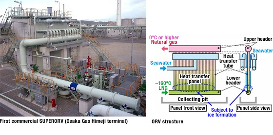

I have never seen LNG seawater vaporizers.  Where did you see these?  Or is the drawing just someone’s idea of a design?  I can see the usual problems of freeze ups and corrosion when using seawater as the heat sink, and perhaps gravity drainage is why the vaporizers are shown tilted or slanted.
I have no idea but on some googling I came across a few seawater units. Not sure if this is established tech. or  just a fancy idea.  @Art probably knows best. For sure, they look a unique design and not a S&T type.
e.g.
What is an ORV?
A vaporizer is a device used to re-gasify liquefied natural gas (LNG), which is cooled at super low temperatures, by heat exchange. The open rack type LNG vaporizer (ORV) uses seawater as its heat source. By running seawater over the aluminum tubes, the LNG inside the tubes converts from a liquid into a gas. Because this method is very cost-efficient to operate and consists of a simplistic structure, it is easy to operate and maintain. It is the safest and most reliable vaporizer. ORVs are normally used for a base load due to these features.
http://www.tokyo-gas...jp/lngtech/orv/

Curious:
What I stated is true.  I have never seen a seawater LNG vaporizer.  However, that doesn't mean that they don't exist - and possibly used a lot.  I do know that when we evaluated using them in the mid-70's we faced serious corrosion, fouling, and freezing problems and so opted for heated types - such as submerged combustion.  I think that some large seawater-based units are used in Japan, but don't know where - and how.

I happen to know a plant that uses seawater... There are quite many others too now.
http://www.slng.com....ct-updates.html
http://www.google.co...6,d.bmk&cad=rja
