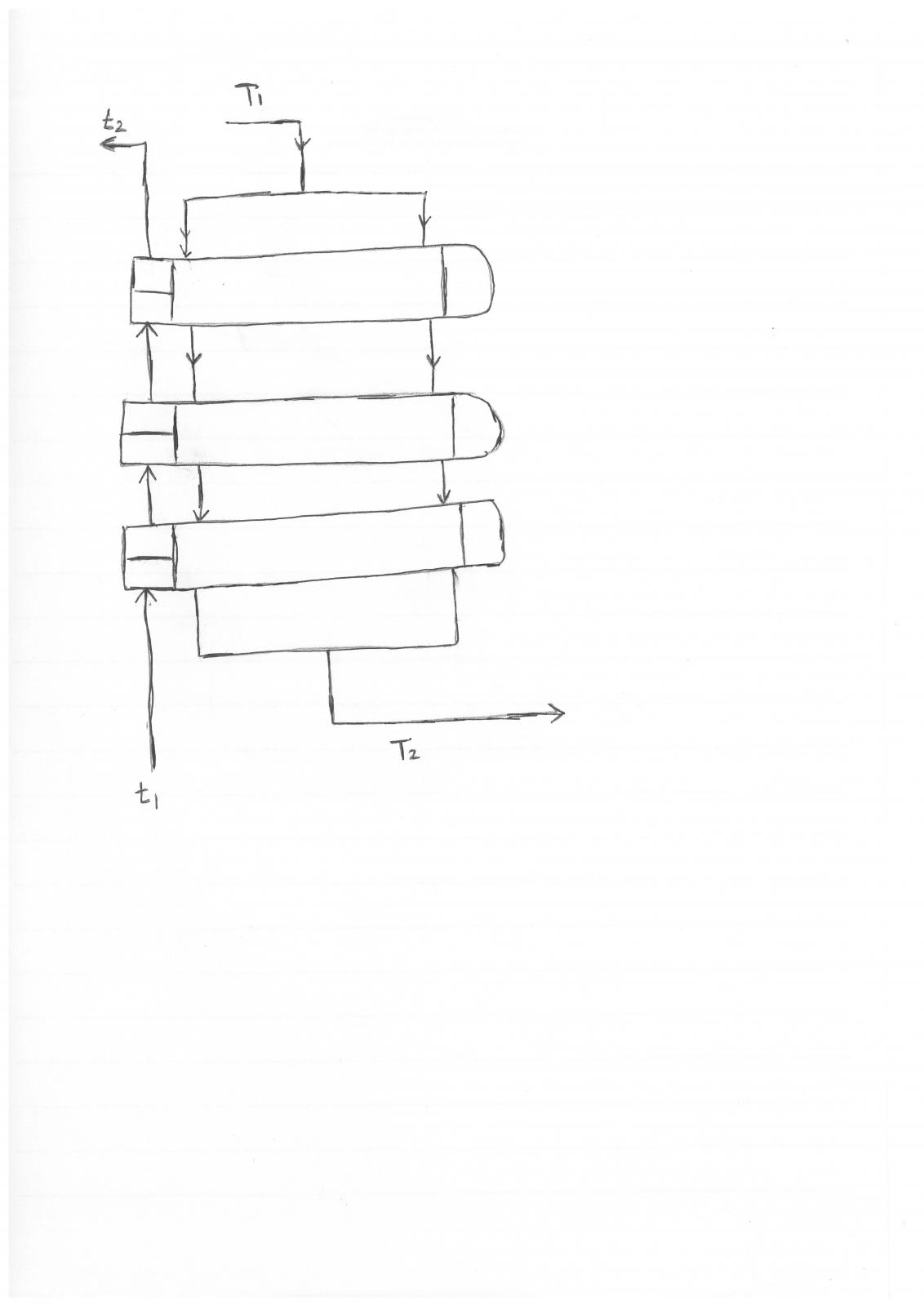

Greetings,
I am having a problem in estimating the correction factor of MTD (FT) for the attached heat exchanger configuration. The known parameters are t1, t2, T1 & T2.
Any one can guide me to the approperiate FT chart or formula?.

I am not sure whether you have understood significance of Ft factor and where it is to be used.
However, in order to calculate Ft factor, you are required to calculate LMTD & caloric temperature. Based on graph as per exchanger geometry, you can get Ft factor.
Forum may be able to help you, if  you describe your problem in detail & your understanding clearly about the assignment.

3 series-2 tube pass arrangement in the excel sheet is close to my configuration.
#8 Bobby Strain
Posted 19 June 2016 - 02:24 PM
Maybe, maybe not. The arrangement you show suggests that the shell side is condensing vapor, and the tube side a single phase cooling media. You need to see the shell baffle detail to get the right configuration. It seems to be primarily cross flow on the shell side.

Dear Bobby,
The shell side is a process gas and the tube side is Boiler feed water. Please find more details in the attached datasheet of the exchanger.

HE-Datasheet1.pdf shows that they are TEMA type DXU heat exchangers. The X indicates cross-flow heat exchangers. You can find LMTD correction factor charts for cross-flow in the Heat Exchanger Design Handbook.

As a academic curiosity, I run HTRI for given datasheet & noted below.
No. of exchanger in series : 3
Exchanger No.  : Hot Inlet, ºC: Hot Outlet, ºC : Cold Inlet, ºC : Cold Outlet, ºC
1                        : 340ºC         : 280.8ºC           : 257.2ºC         : 310ºC
2                        : 280.8ºC      : 235.4ºC           : 216.6ºC         : 257.5ºC
3                        : 235.4ºC      : 200ºC              : 185ºC            : 216.6ºC
I guess, in absence of above data, Said Salim was experiencing problem of estimating Ft factor. Please correct me if I am wrong.
However, concern still remains is how to estimate these terminal temperatures for DXU type configuration, without help of HTRI.

Cea you are right I have a problem estimating Ft factor.Anybody can suggest how evaluate the performance of this exchanger?
#13 cea
cea
  • 108 posts
Posted 21 June 2016 - 06:17 AM
Well. Now when you have terminal temperature with you for each exchanger in series, you may refer to applicable graphs for exchanger geometry wherein you can read Ft factor directly based on terminal temperature. Well known source can be Kern Book.
