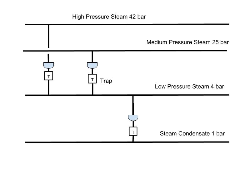

At our plant, we have High-Pressure 42 bar Steam & Medium-Pressure 25 bar Steam lines. The steam traps on drip legs on these steam lines are connected to Low-Pressure 4 bar Steam line.
Why aren't they connected to our Pressurized condensate line instead? whats the logic?
Thanks
