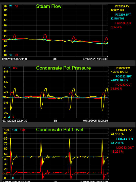

Hi Dear Engineers,
I'm reaching out for your support in understanding a recurrent issue with cyclic steam pressure pulsations.

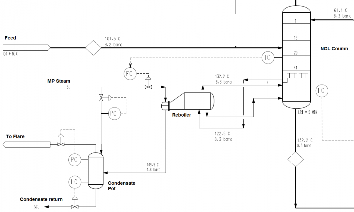

We have a reboiler installed at the bottom of the NGL column that use MP steam as a heating medium. The reboiler vapor return temperature is controlled by a steam flow control valve. The condensed steam is routed to a condensate pot where the pressure is controlled by pressure control valve using also the MP steam. The pot is also equipped with a level control valve.
The concern:
We are experiencing a cyclic pressure pulsation in the condensate pot causing a mild intermittent hammering even though the column operation is steady and no operating parameters are changing.
Any insight or technical guidance to help me understand the root cause would be highly appreciated.
Thank you in advance for your support.
N.B: I have attached a DSC screenshot and the process PFD for more clarity.

1. We tried to operate all controllers in Man since we suspected some kind of valve stickiness or positioners malfunction. But same behaviour observed in Man.
2. the bypass steam to the pot is needed to maintain a pressure of 5 barg. The downstream pressure in the condensate return is 1 barg.

What is the time base of apparition of the spikes, it seems to be hours between them, same amplitude, same period. So, nothing to do with controllers. You need to check the events in your process or utilities which could match this time.
Do you have way to scroll back the historical data to find when this started? it could be operation/action from the team. Do you have specific actions from operators or PLC/DCS at a given time during the shift.

There is a constant cycle of the pot level perturbation. From the graph, it seems to be coming from the steam floe or related to it. Usually, when a period on control variables is observed in a distillation column, it comes of a perturbations in the feed or condenser.
Track the column variables and match on time with the level pot, searching if they are related.

For context, we have 2 identical trains supplied from the same steam header. One train is operating smoothly without any spikes, while the second train is experiencing these intermittent spikes at flow above 4800 kg/h of steam.
At this stage, I suspect a potential hydraulic related issues. I wanted to visit site to evaluate this, unfortunately due health condition, I am currently unable to do so.
That's why I am reaching out here to leverage the experience of other professional people. Any insight is appreciated.

  1. PCV on Pressure Equalization Line: Could you clarify the purpose of having a PCV on the pressure equalization line? Since both the condensate (into the pot) and steam inlet are at nearly the same pressure (with only a marginal difference), the need for this control is not immediately clear.
  2. Sizing Basis for PCV and LCV: Please review the sizing basis for the PCV (on the equalization line) and the LCV (at the pot outlet). These valves should be adequately sized to cover the entire operating range.
  3.  Additionally, it would have been preferable to have the equalization line tapping after the FCV.
