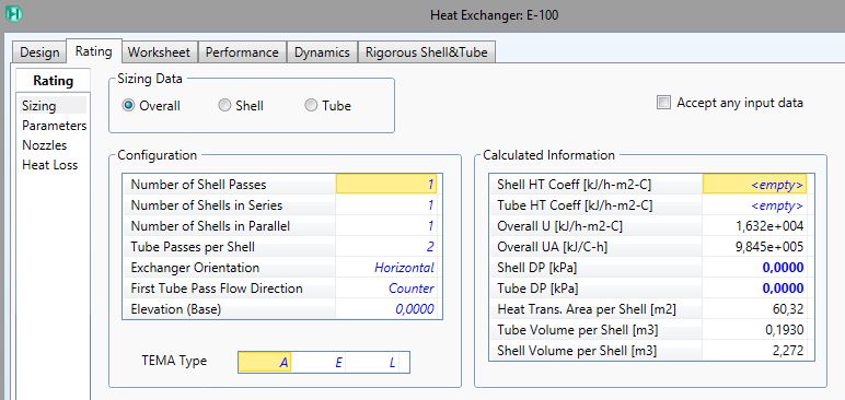

#6 gegio1960
gegio1960
  • 518 posts
Posted 16 June 2019 - 11:29 AM
Hi Abul.
Just to follow your question I tried to input your data in hysys.
Other data should be known but, as a starting point, you can find attached the 1st trial output of the HE.
When you say "Aspen HYSYS predicts a heat trasnsfer coefficient of 8430 Kj/hr.m2.C", do you refer to the U value shown in the picture? (it is 16320 in my case)
Edited by gegio1960, 16 June 2019 - 11:32 AM.

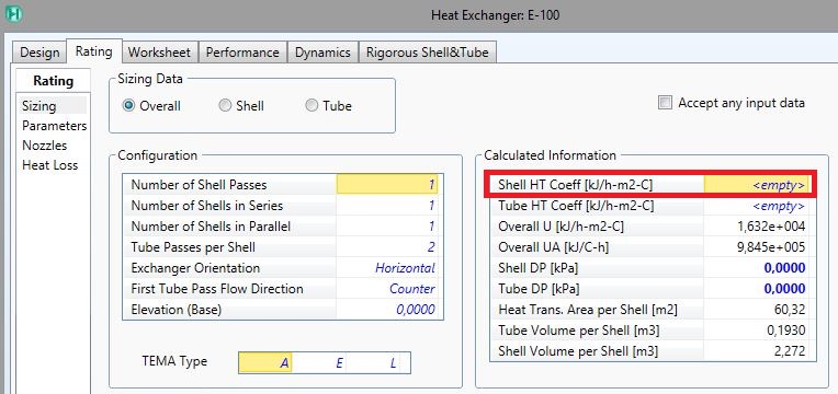

#8 abolghasem202
abolghasem202
  • 17 posts
Posted 18 June 2019 - 12:13 AM
Hi Abul.
Hi Gegio,
Thank you for your response.
I meant the heat transfer coefficient, signed by red color in the attached picture. I think the heat exchanger should be in rating mode to show the shell and tube heat transfer coefficient values.
The calculated U value in my simulation is 2100 kJ/m2.hr.C.
