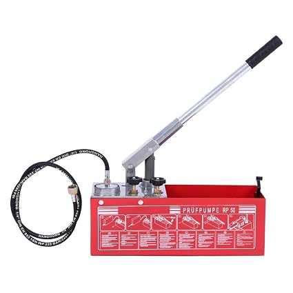

Be more specific about your task . I know a story of a worker  killed doing pressure test on HX using compressed air, the HX bursted... !
You should be using water together  with a designed hand pump to build up the pressure .

To be clear with you  don't use compressed air to perform this kind of test !
Please read my initial answer and go through the document I passed to you and others  to understand the risks . If you need more info about hydraulic leak test use your favorite search engine .
Hope this is understood .
