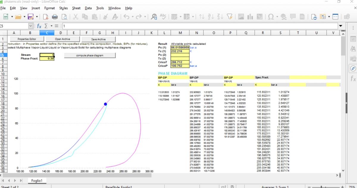

Hi to all,
how to review the gas composition w.r.t phase envelope and cricondenbar? how these will affect natural gas separation(LTS separation) and hydrate formation.
Here i have attached phase envelope. PFA

I attach the phase diagram calculated with GERG 2008 model (in Libre Office)
the reported CricondenBar is about 100 Bar,
