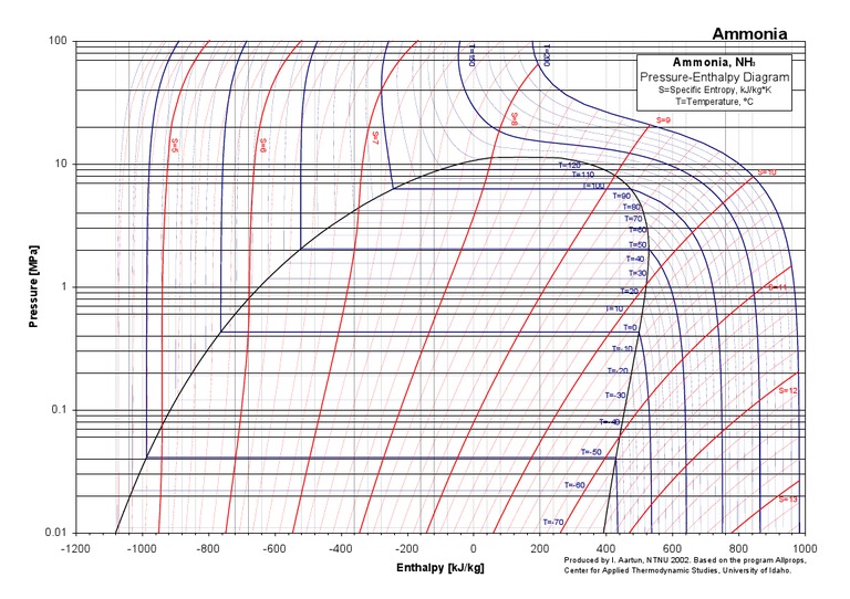

#10 Pilesar
  • 1,699 posts
Posted 30 March 2022 - 01:15 AM   Best Answer
Become familiar with how to read a pressure-enthalpy diagram. https://imgv2-2-f.sc.../1595838359?v=1 The liquid ammonia at your source conditions can be found on such a diagram. The flash drum conditions can also be found on such a diagram. No matter how the flash drum conditions are reached, the point on the diagram is the same and the amount of vapor and liquid will be the same as long as the pressure and enthalpy are the same. So what does the valve in between do? It helps describe the path the fluid will take from one condition to the other. The fluid at the new pressure will have the same enthalpy as the fluid in the source tank but at a lower pressure. This allows you to trace the path from the source point and find the new location on the chart! You can calculate the amount of vapor and liquid at the new point based on the enthalpy and pressure.
  Note that the new flash drum conditions might be reached by a different method depending on the starting point by adding heat, adding pressure, reducing pressure through a turbine, etc. Once the fluid was at the same pressure and enthalpy conditions, the amount of vapor and liquid would be the same. The purpose of the valve in real life is to allow the ammonia to exist in the system at two different points on the diagram. The upstream vessel would need some way to control its inventory (keep a constant pressure or liquid level) and this valve might serve that purpose for the upstream vessel just as the downstream vessel also has a liquid control valve.
  I don't think the actual controls are part of what you are studying since they aren't shown on your diagram. In brief, a valve can only help control one thing at a time such as pressure, flow, temperature. The control designer chooses which parameter is modified by each control element. For example in your sketch, if the in-between valve were missing, the vapor might blow through the exchanger without condensing which would affect both the compressor operation and the conditions downstream. I think of the valve as a boundary between the two points on the pressure-enthalpy diagram.
  Don't stress over not fully understanding what is happening in your system and why. It will come to you eventually and you will find an explanation that makes sense to you. Have you tried watching some video tutorials on the web? Search for 'refrigeration cycle' and see what you find. If you can understand how a car air conditioner works, you will understand the ammonia refrigeration cycle.
