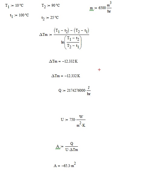

Could somebody check whether I made correct calculations. Thank you.
I need to design a shell and tube heat exchanger to heat up the water. For heating, water vapor at 100degC will be used in shell side.
TUBES
Flow of water 6500m3/hr
Temp of heated water 90degC
Temp initial of water 10degC
SHELL
Flow of water vapor 1500kg/hr
Water vapor at 100degC
Energy from water vapor assume 2200kJ/kg * by amount of water vapor 1500 kg/hr = 3 300 000kJ/hr
Energy needed to heat up the water 2 174 276kJ/hr
70m2 heat exchanger will be ok for such application? What else should I take into account when design such S&T heat exchanger?
Thank you
Tomasz

Hi ,
You need to go back to the basics , probably take a look at your notes .
How can you get negative Surface ???
It seems to me you don't know how to perform an heat balance .
Energy in = Energy out .
During heat transfer , the steam will be converted to water , energy transferred is the latent heat * steam flow rate ,meaning the temperature of the outlet water is the same than the steam inlet .
Review the DT ml accordingly..
Anyway I will supply some documents to support your work .
