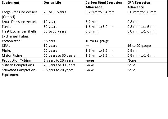

Corrosion control is required when the calculated general corrosion rate cannot be accommodated by reasonable corrosion allowances for carbon steel, as listed in the attached table. For example, if the predicted corrosion rate is 10 mils per year (mpy) for a heat exchanger shell with a 20 year design life, a corrosion allowance of 0.20 inches would be required. This result is considered unreasonable. In this case, corrosion would have to be controlled by at least one of the following methods:

Equipment Design Life: Basis of Selecting CRAs over Carbon Steel:

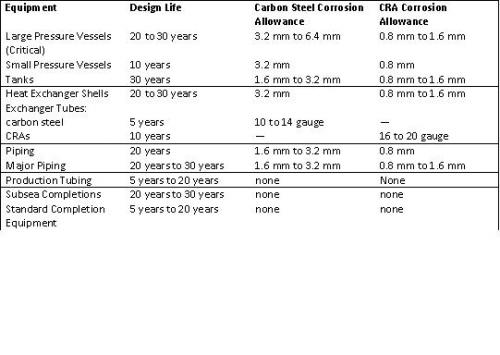

The attachment lists typical design lives and corrosion allowances for carbon steel and CRAs as they apply to specific equipment. A corrosion allowance is defined as excess material not required for the design thickness according to the appropriate design code. The engineer is responsible for choosing the correct corrosion allowance. Design codes do not set corrosion allowances.
Design life for surface facilities is set by inspection capabilities balanced with operating constraints such as the cost of opening equipment for inspection and the feasibility of replacing equipment at the plant site. Therefore, offshore facilities will have more conservative design lives than onshore facilities. Unlike surface facilities, completion equipment and production tubing have no corrosion allowances. Therefore, corrosion control is critical. If predicted corrosion rates are unacceptable for the design life of the carbon steel completion, then CRAs, nonmetallic materials, coatings, or chemicals are required.
