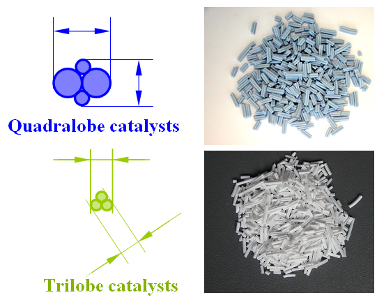

Every process design is an economic optimum.
A smaller diameter catalyst particle will have shorter pores than a somewhat larger particle, but I think that most of the action is at the pore area in the outer layer of the particle anyway, even in the smallest catalyst particles.
A radial flow reactor requires a bigger, and therefor more costly, reactor vessel for the same amount of catalyst than a normal axial reactor. Simply stated: a radial reactor contains more empty volume then an axial one.
A radial reactor is only suitable for single phase flow, not for mixed phase.
So what do you want (if pressure drop or mixed phase flow are not determining): more useless space in a radial reactor, or a little more useless catalyst material in the center of somewhat bigger particles in an axial reactor.
A lot of catalyst particles are extrudates. These need to have a certain strength to prevent them from crushing before even reaching the reactor, or when dumped into the reactor. To have the benefits of small diameter related effectiveness, as well as the benefits of larger diameter related increased strength and lower pressure drop, vendors invented the quadralobe and trilobe catayst extrudates:
