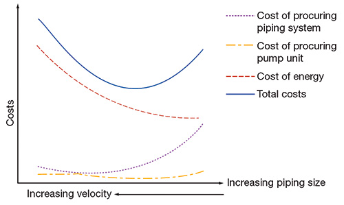

Hello everyone,
I am trying to do pipe sizing for my design project, I am taking the approach of calculating the capital and operating costs of different size diameters for a set flow, then summing the CAP & OP-EX (Capital costs will be spread over 5 years).
I am currently at a bottle neck where I require estimates of pipe costs for different diameters and materials, any help in finding these would be greatly appreciated.
Ayrton

Apologies for the ambiguous description. I have a volumetric flowrate of liquid solvent (1828 m3/hr) at as you say at a set pressure and temperature (318K & 3.5 bar). I'm slightly confused by the context you use depreciation in, I am used to using depreciation to describe the loss in value of capital over time, I am trying to say that the upfront CAPEX will be paid off over a period of 5 years (this is a nominal time period, will probably settle on ca.10 but need to read more literature).
"Perhaps you are meaning to find an optimized piping size for a specific project scope of work?" - That is indeed my intent, I am creating a Matlab model which when given a fluid flowrate and physical parameters calculates the energy costs (from pumping) as well as capital costs (of pump & piping), it then splits the capital costs over a set pay-off time and calculates an annual cost alongside an annual energy cost. These costs will be calculated for a range of diameters and the diameter which has the lowest total cost will be chosen.

To clarify my initial question further, the different diameters and materials I am trying to find prices for range from 2" to 36" of initially 310 & 316 steel but if possible carbon steel too

Hello Ayrton ,
Probably good to read this document .
Good luck.
