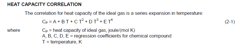

I am doing the H-H25 energy balance for scrubber. After cross check with old excel provided by my superior. I found out the integration is different.
For example, to calculate H-H25 of O2 at 300 C, I integrate the heat capacity correlation and form the following formula.
h_25 = (a * T + 1 / 2 * b * T ^ 2 + 1 / 3 * c * T ^ 3 + 1 / 4 * d * T ^ 4 + 1 / 5 * e * T ^ 5) / M - (a * 298.15 + 1 / 2 * b * 298.15 ^ 2 + 1 / 3 * c * 298.15 ^ 3 + 1 / 4 * d * 298.15 ^ 4 + 1 / 5 * e * 298.15 ^ 5)
however I found out that the excel is using
h_25 = (a * T + 2 * b * c / (exp(2 * c / T) - 1) + 2 * d * e / (exp(2 * e / T) + 1) - a * 298.15 - 2 * b * c / (exp(2 * c / 298.15) - 1) - 2 * d * e / (exp(2 * e / 298.15) + 1)
My question is, why they are using different integration method

https://www.cheric.o...d=1935&prop=CPG
Not using the same correlation !
note : the coefficients a,b,c,d  are not the same ….
I've added a link to a Korean Data base which is using a similar polynomial form .

To add to my previous reply other correlations with range of applicability .
Document issued by Ankur (moderator in this forum)  a few years ago.
Edited by breizh, 28 October 2019 - 12:46 AM.

Hi Breizh,
Really appreciate your time and help. I just got to know there is different coefficient for this calculation.
It raised another question. which coefficient is more accurate ? The temperature range is around 25c to 500 c
Edited by coolgoh98, 28 October 2019 - 06:32 AM.

Hi ,
It's up to you ….!
To me the polynomial form is good enough for this type of calculation [design of a scrubber ].
note : Do the math and make your own conclusion .
