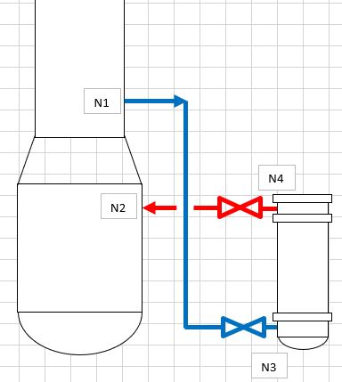

I'm currently looking at a once-through, vertical design (figure attached) for a project I'm working on.
I can provide numbers but I suppose a qualitative discussion should suffice for what I want to ask at this point.
Below is how I understand how the system works:
1. Liquid from column is taken at constant (L1).
2. Nozzle draw off in column (N1) location is higher than the reboiler outlet return nozzle in column (N2).
3. For the sake of discussion, we assume that reboiler outlet nozzle (N3) elevation is same with N2.
4. Flow goes across the reboiler from the bottom, going up.
5. If there's no heat input in the reboiler, the effective flow to the reboiler (L2) will be determined by the available static head (N1-N2) going against the total resistance of the circuit, which would be from the inlet and the outlet piping pressure drop, as well as the pressure drop inside the exchanger (with pure liquid flowing as heat input =0).
6. If L2 > L1, then you will draw more liquid than what's coming from the column, so it follows that the inlet piping to the reboiler will be partially filled with liquid. If L2 < L1, you will have back up of liquid in your column.
7. Exchanger elevation relative to column has little effect in L2.
If heat is applied to the reboiler:
8. You will have pressure drop increase in both reboiler outlet piping and inside the reboiler itself due to two phase flowing
9. However, the static head will change inside the reboiler due to presence of vapor.
10. In this case, point 7 no longer applies and change in exchanger elevation relative to column will have an effect in L2. I think this is the essence of doing the thermosyphon hydraulics, to establish the height required to make L2 = L1
Here are my questions:
1. My intuition tells me that if we follow the schematic above, you will always have driving force to establish flow and it is possible to have more driving force than required by the system to establish L1. If that's the case, shall I expect the reboiler inlet piping to be partially filled with liquid? Since the fluid is saturated, shall I expect flashing within this line?
2. We design the reboiler to provide enough surface area to allow a liquid with flow L1 to boil off to a target vapor fraction, for a given heat duty (and steam flow, by extension). In reality, if the flow to the reboiler is different from design (say L2 > L1), you will produce a different vapor fraction at your reboiler process outlet, and the heat duty may be different from design since your heat transfer coefficient might change due to differences in boiling regime. How do we ensure that we are designing the thermosyphon circuit will actually work as intended?

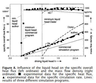

Probably good to study the papers attached.

This is not a true thermosyphon but a forced feed reboiler. It is once through and vaporization is set by the heat duty. Thermosyphons can be designed to develop a predetermined vapor fraction at the outlet. This requires re-circulation of some of the outlet liquid. You must have some reason for using the exchanger you describe. Probably a wide boiling range material. Or a solvent absorber system where there is a large temperature difference between the solvent and solute.
Without knowing what the components are, it's impossible to make suggestions about the appropriateness of such a system.

For more info: The current design I'm working on (based on thermal rating and with the reboiler outlet nozzle elevation = column reboiler product inlet nozzle, same as with the sketch I shared) will result in available head for thermosyphon flow (AHTF) > required head for thermosyphon flow (RHTF) (these abbreviations are from client standards by the way). Client standard requires a balancing line from the vapor section of the draw off tray to the reboiler inlet piping if AHTF > RHTF.
To make AHTF = RHTF, I need to elevate the reboiler, which does not make any sense from construction point of view (unnecessarily increase structure/foundation costs, just to kill the head?). So this has triggered all this mental gymnastics in my head making sense of it.
One document breizh provided has given me insight (see attached). It essentially says that changing the head (within optimal range) while results in varying circulation rate, will not vary much the heat flux (essentially heat duty) at the reboiler. So it answers one of my question (ensuring duty will remain the same). So what's left is how to ensure that we maintain the target circulation rate.
To kill the head, the balancing line will introduce vapor at the reboiler inlet to maintain the flow from the column to the reboiler. It makes sense to me. Or does it?

Design the heat exchanger such that it fits your available head, with some margin. And pay attention to the design of the draw tray and piping. It's a fairly simple hydraulic calculation. HTRI or other design programs should be able to do all this for you. A balancing line is useless; it will only fill with liquid. If you want to have some control, provide a full-open ball valve in the liquid inlet.

I did for HTRI and also did manual calculation, both agreed that more than enough head is present.
I wish I can make direct quote of our client standard, but it is specifically mentioned that this is needed if available head > required head.
The balancing line in particular is required to be at the vapor space of the drawoff tray, so its intent is to introduce vapor to the reboiler inlet line.
Going back to what I have: Since the current exchanger is oriented vertically (facility is limited in plot space), aligning the reboiler outlet line with the reboiler outlet to column nozzle (see attached sketch in my 1st post), available head > required head. I can remedy this by lifting the reboiler to some extent, but (1) it will be a waste of foundation/structure and (2) the reboiler outlet nozzle will be above the corresponding column nozzle, which I have never seen in my experience.
