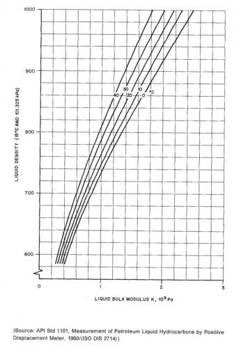

The wave velocity "a" is given by:
a = square root(1 / ((1/K + (d/tw)*(1/E))*ρ))
where:
K = Liquid Bulk Modulus (refer attachment); water bulk modulus is generally considered as 2.2*109 Pa
d = pipe internal diameter, m
tw = pipe wall thickness, m
E = Young's modulus of pipe material, Pa (for commercial steel it is considered as 210*109 Pa)

  • Attached Image
