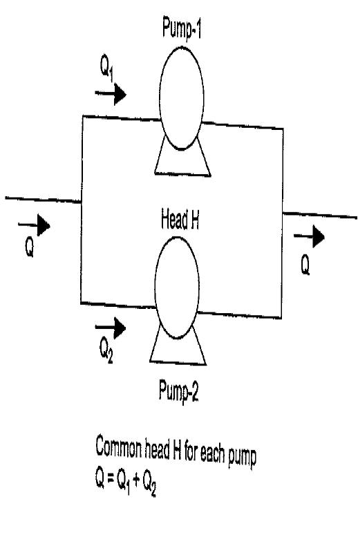

Let us now move on to pumps in parallel. As mentioned earlier, for pumps configured in parallel, the flow rate Q is split between the pumps at the inlet into Q1 and Q2 and after passing through the pumps on the discharge side, the flows recombine back to the flow rate of Q, as shown in attached sketch 4. Each pump develops the same head H at the corresponding capacity. Thus, the first pump at capacity Q1 develops the same head H as the second pump at capacity Q2. This commonality of head across parallel pumps is the most important feature of pumps installed in parallel. If the pump heads are not matched, pumps in parallel will not function properly.
Consider two identical pumps, each with the H-Q curve, as shown in sketch 5. The combined H-Q curve in parallel operation is labeled in the figure as two pumps in parallel. At a head of 1200 ft, the capacity of each pump is 1000 gpm. Therefore, in combination, the parallel pumps will be capable of pumping 2000 gpm, generating a common head of 1200 ft. Every point on the combined H-Q curve has a capacity double that of each pump at the same head.
Therefore, when installed in parallel, the flow rates are additive, while the head across each pump is the same. Suppose there are three identical pumps, each developing 800-ft head at a capacity of 400 gpm. When configured in parallel, the flow rate of 1200 gpm is split equally through each pump (400 gpm each), and each pump develops a head of 800 ft. Thus, the total flow is:
QT = 400 + 400 + 400=1200 gpm
And the common head across each pump is H1 = H2 = H3 = 800 ft
To conclude, pumps in series have a common flow rate with heads being additive. With pumps in parallel, the flow rates are additive with a common head.

Very nice article sir But shouldnt the output flowrate of a two pumps in parallel configuration depend on where the system curve intersects the new combined pump curve. So in theory for two pumps(rated at say H,Q) in parallel the total flowrate would be greater than Q but lower than 2Q and each pump would operate at a point to the left of the rated flow on its curve at head greater than H and flow less than Q
When you design a pump system considering 2 or 3 parallel pumps, the connected piping (common suction, individual suction, individual discharge and common discharge) is designed with 2 or 3 parallel pumps. In such a case the pump manufacurer will ensure that the system curve intersects the combined pump curve at the rated point providing the rated flow for the required head. It means that the two or three pumps are exactly identical producing half the rated flow when run individually for the required head.
Essentially it means that the system curve itself will not remain the same if you run a single pump instead of two or three pumps for a pumping system designed for two or three pumps running in parallel.

Ankur,
Very good article indeed.
I have this configuration wherein the two Centrifugal pumps are in parallel.
Existing pump : 1000 m3/hr
Head :   162 m
Shut off head : 196.54 m
Motor Rating : 560 kW
RPM : 1800
This existing pump will run in parallel to the new pump whose parameters i mentioned below:
New pump in parallel with above : 2200 m3/hr
Head : 107 m
Shut off head : 129 m
Motor Rating : 730 kw ( yet to be decided)
RPM : 1800 / 1200 (1 vendor quoted)
My question,  is it possible to run this pump in parallel with the existing pumps since nothing is matching with the existing pump except the liquid service.
Nor the shut off head, nor the flow, neither the rpm for 1 vendor.
What do you think, is it still possible to connect those pumps in parallel ?
Prasanjit,
Not a very great idea. Behavior will be unpredictable for both the pumps (the high capacity low head and low capacity higher head pump). It is possible that the low capacity pump (1000 m3/.h) may run at end of curve when the new higher capacity pump is hooked up in parallel, which is not desirable.
One overlooked aspect of fixed speed dissimilar pumps operating in parallel is the adverse effect on the pump motor which may overload or heat up leading to frequent motor trips or in a worst case scenario cause motor winding burn-out.
An alternative to connect your new pump with the existing dissimilar pump would be to provide a variable speed motor for the new pump to adjust the pump flow to match with the existing pump.
Hope this helps.
Ankur.
