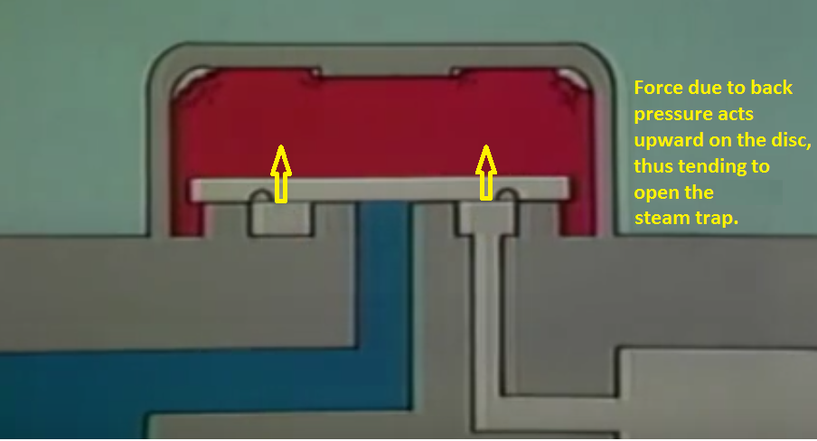

#5 Lucian Gomoescu
Lucian Gomoescu
  • 44 posts
Posted 24 October 2015 - 04:19 PM
Hello,
The type of stream trap mentioned above would fail open in case of a back pressure which exceeds the max. allowable limit. This is because the back pressure tends to lift the disc (see attached drawing).
