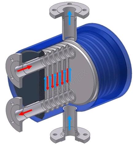

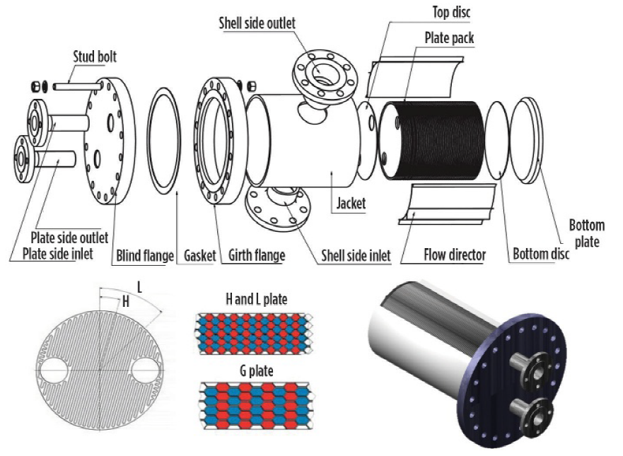

Thank you for your responses, but the exchanger I am looking for is Plate and Shell heat exchangers, not Plate and Frame Heat Exchanger. Here is some pictures of it. And yes, it has a shell.
Hope you have a nice day.
Cuong

http://www.gesmex.com/en/dimensioning
You may consider to contact this German company for your query . it seems that HTRI has option for this particular type of HEX , circular plate and frame (shell) heat exchanger.
note: To get a meaningful answer you should tell us the issues you are facing .

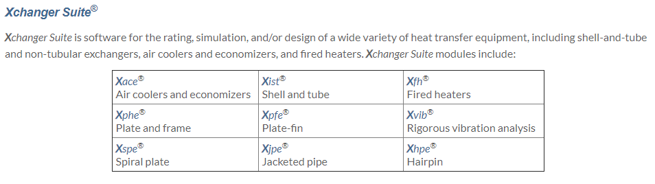

Dear Mr. Breizh,
Thank you for your reply.
I checked with HTRI Xchanger Suite and there is no option for this type of heat exchanger.
As I wrote above, I am making some calculation to evaluate performance of some types of heat exchangers. And I am hitting the wall when coming up with Plate and Shell Heat Exchanger. I do not know how to determine the heat transfer coeffficient for this equipment.

https://www.htri.net...nger-technology
Hi Cuong
take a look at the link above !
Unless you have the data sheet of the existing equipment there is no chance to get access to the heat transfer coefficient .
The heat transfer coefficient is very much linked to the design of the plate .
My view
