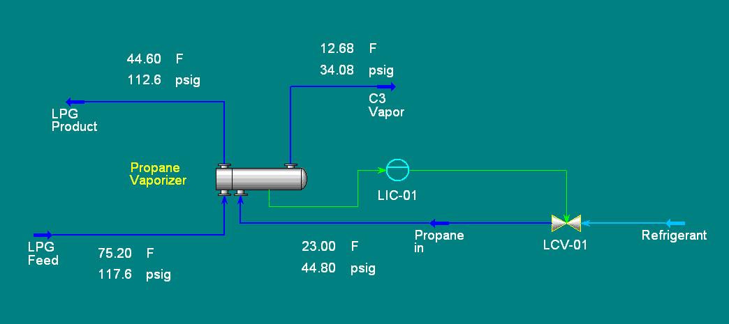

#9 Zauberberg
Zauberberg
  • 2,728 posts
Posted 11 August 2010 - 02:38 PM
1. The refrigerant (Propane) does not meet the outlet conditions you specified. In reality - assuming that you are dealing with 100% pure Propane - the true conditions will be as indicated by Art; similar results are obtained by Aspen software (see attached sketch). What is the actual composition of refrigerant? It is very impractical to consider 100% pure Propane in industrial applications, unless you are in very specific position to have such a luxury.
2. Secondly, it's practically impossible to design S&T exchanger with no pressure drop in the tube-side. For a two-pass U-tube design (no reason not to employ AKU or BKU design instead of having floating head - I have almost made that mistake once), assuming 0.3 - 0.7 bar pressure drop is reasonable. You will calculate the actual pressure drop once when you confirm the tube layout resulting in the overall heat transfer coefficient you have selected for your final design. On the other hand, having virtually zero pressure drop across the shell is fairly OK for evaporators.
3. The outlet temperature approach seems to be unreasonably high (~18 degC), you may go for lower values and see what differences (in the overall heat transfer area requirements) you get. In reality, this temperature will be driven by the suction pressure of Propane refrigerant compressor, which should be an independent variable in the process, in order to allow for duty trimming and proper utilization of Propane condensers/Compressor power saving.
4. As for the boiling/overall heat transfer coefficient, you can refer to Ludwig's "Applied Process Design" and Kern's "Process Heat Transfer", as they offer complete procedure for evaporator/reboiler design. If you have any of the software tools such as Hetran/HTFS or HTRI in your company, you may run it a few times and seek for optimum design - but first make sure that you can do it by hand calculations in order to be 100% confident in what you are getting from the software.

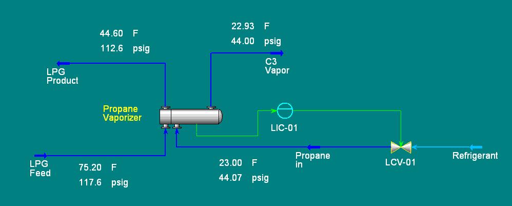

#10 Zauberberg
Zauberberg
  • 2,728 posts
Posted 11 August 2010 - 02:59 PM
A very important point I forgot to mention is that - there cannot be such a huge temperature drop across the shell-side in boiling applications, as shown on the sketch I have uploaded and which was based on your initial data. Both Propane inlet and outlet temperatures will be almost identical, since it is a latent heat transfer application.

#13 Art Montemayor
  • 5,783 posts
Posted 12 August 2010 - 09:32 AM
All:
Guys, before we spend any more time and effort on this topic, let’s get the basics straight – once and for all:
1) This thread has originated from one that had little or no basic data;
2) Then it went to an extended explanation of the scope of work;
3) The basic data furnished was erroneous;
4) The basic data and scope now start to appear as what I had suspected all along – this is NOT a heat exchange problem. This is an attempt to unload saturated LPG from a road tanker truck into a low-temperature LPG storage tank by using a Propane refrigeration system to lower the LPG vapor pressure.
The REAL story now appears as follows:
1) The LPG being unloaded is saturated at ambient temperature (as I suspected) and 100 psig. The low temperature Storage Sphere exists at 44 oF and 57 psig.
2) What is being proposed is to use a vapor displacement type of unloading system to transfer the tanker truck LPG through a Propane Vaporizer coil (the proposed “kettle exchanger”) and into the Sphere as sub-cooled LPG.
3) The Propane Vaporizer is a unit unto itself as it is part of a closed Propane refrigeration unit.
4) As has clearly been pointed out, this is not a conventional heat exchanger problem. This is a refrigeration vaporizer application – straight and simple.
5) What is getting very complex and mixed-up is the proposal to employ mechanical energy in the form of a vapor compressor to forcefully displace the vapors in the Sphere with higher pressure liquid that exists in the tanker truck. This, in my opinion, is totally illogical and wasteful. A pressure driving force already exists inherently in the proposed unloading system. There is no need for an unloading compressor if we are to believe the vapor pressure data.
6) All that is simply required is to employ a Propane vaporizer (a standard BKU design is fine and OK; a floating tube bundle type – such as AKT – is ludicrous because there is no justification for this type that is meant for dirty tube-side fluids and is prone to leakage through the internal gasketed joint, especially in a service that has a temperature gradient) and connect the road tanker directly to the vaporizer-subcooler with an expansion/control valve before the vaporizer to contol the pressure downstream. The vaporizer will subcool and condense the subsequent products of the LPG expansion.
7) Another option is to simply expand the 100 psig LPG DIRECTLY into the Sphere and use the Propane vaporizer as a condenser for the subsequent expansion vapors. I have favored this method in the past because of its simplicity and economy of capital and operating costs – especially when one already has a refrigeration system installed to control the Sphere vapor pressure – which would be a normal design criterion. However, this entails having an elevated condenser.
I have commented and marked up the Rev3 workbook that I am attaching. I have had to do this in Spanish out of courtesy and convenience for the originator.
The original thread has been completely turned around and mixed up. This, as usual, is due to a reluctance or un-willingness on the part of OP to share and contribute ALL of the basic data and scope of work at the very outset of the thread – as well pointed out by Zauberberg. I recommend we conserve our energy and comments until we get confirmation and agreement on the part of the OP regarding what I have stated here. This is a very practical and interesting problem to resolve – but we need FULL cooperation and input from the OP. It is too bad that we couldn’t get this at the very start.
